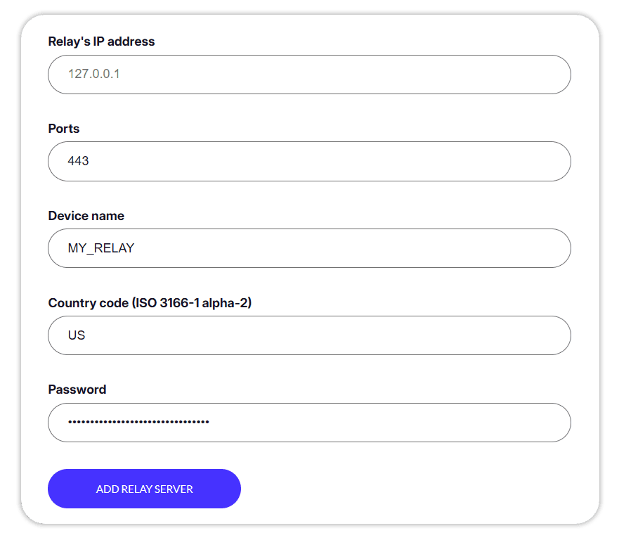

4. Registering the relay in your account
Sign in at remotly.com, open Custom Relays and click Add relay server. Provide the IP address, the port(s) from RelayGoConfig.json, a device name visible in the apps, the country code and the same password as in the configuration file.
Custom relays panel in the Remotly user panel
Add relay server form
When connecting to another computer with Force Connect Anywhere enabled, you should now see only the country code and name of your private relay.
